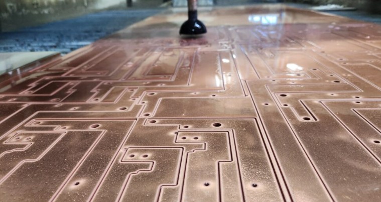

With customers looking for faster turnarounds and shorter deadlines, and sales projections looking positive, Waterjet West Inc. upgraded their shop to add a third abrasive water jet cutting system. A waterjet-only job shop in San Diego's North County, Waterjet West was running their two OMAX 55100 JetMachining Centers at near full capacity, creating customized parts for diverse industries such as aerospace, medical, architectural, and energy. The inherent benefits of abrasive waterjet machining, coupled with its high versatility, allowed Waterjet West to provide just-in-time manufacturing, reverse engineering solutions, and overall quick turnaround cutting services. This flexibility allowed the company to expand their customer base, even during times of economic fluctuation.
"If I spent the same amount of money to purchase a laser instead of a waterjet, I would be cutting strictly sheet metal and thinner gauge material," says Scott Cormany, owner of Waterjet West. "With waterjet, there is room to expand." After restructuring their shop and upgrading their power, Scott added an OMAX 60120 bridge-style JetMachining Center, complete with the advanced Tilt-AJet taper elimination cutting head. The 60120 is capable of cutting 5' x 10' sheets with ease, and the Tilt-A-Jet automatically adjusts to eliminate taper from the parts, resulting in precision edges that often require no secondary finishing. With faster cutting and shorter production cycles, they are able to better meet the shorter deadlines of their clients.
