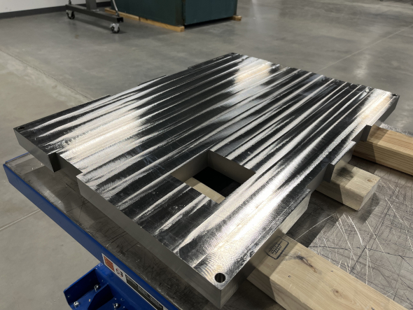

One of the key steps in the RPD® process is to cut the raw material, which is titanium plate, into individual substrates sized to the geometry of the part to be printed. Previously, Norsk Titanium outsourced this step to a local vendor, which resulted in longer lead times, higher costs, and more material waste.
To overcome these challenges, Norsk Titanium decided to invest in a waterjet cutting machine. The water jet cutter allows Norsk Titanium to cut its own substrates in-house, with more precision, speed, and flexibility.

The waterjet cutter also enables Norsk Titanium to explore and develop a more near net shape, which means that the substrate has a similar shape to the final part, rather than a rectangular shape. This reduces the amount of material that is machined, saving time and money for both Norsk Titanium and its customers.
