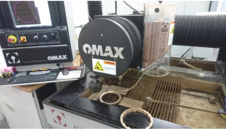

“Our OMAX waterjet allows us to produce ratchet rings from brass bronze for our load arrestor blocks, high performance rockers for vintage motorcycle championships, as well as custom marine engine transom plates and other various bespoke fittings,” said Andre Beard owner of Ash Safety. “Our APL Load Arrestors could hold rivet guns and tools with weights up to 800kgs each. Jaguar Land Rover used our APL’s as there was no other device on the market that could fulfill their exact requirements. The introduction of these units has significantly increased safety.”
Ash Safety's custom rockers. Started by being blanked out on the OMAX 2626, the finished ins secondary machining. The rockers were installed on at 1956 250 Royal Enfield Crusader that was prepared for the Vintage Motorcycle Club Historic Racing. The bike has won 4 national championships.

The OMAX 2626 is a fast, and precise cutting tool with the versatility to cut virtually any material. With a cutting envelope of 737mm x 660 mm, the waterjet is a perfect complement to a prototyping shop or a production floor where space is at a premium. Complement the waterjet with a 200 L abrasive hopper, like Ash Safety has, and the machine can cut for hours with minimal downtime. Ash Safety’s 30hp EnduroMAX pump coupled with the 2626 is a simple yet robust pump that is specifically engineered to simplify maintenance through innovative features such as independent cylinders. The combination of cutting table, hopper, and pump are geared to increase uptime to accommodate hours upon hours of continual waterjet cutting.
