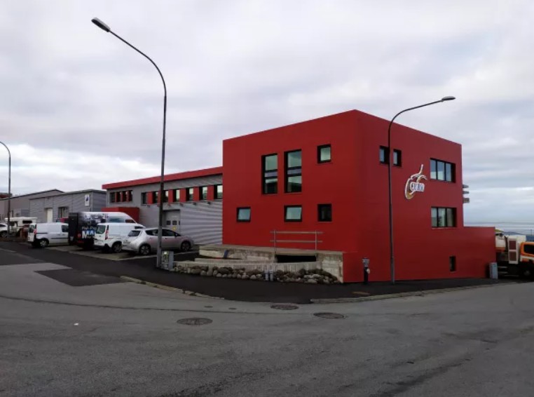

n Hafnarfjordur, Iceland, Curio ehf. builds five different machines for fish processing with the help of four OMAX-brand waterjets.
Whether filleting, skinning, or heading, each of Curio’s machines come in a range of sizes that handle fish up to 18 kg (39.6 lbs). Curio touts that it brings “devotion inherent in handmade machinery parts, technical innovation and Icelandic ingenuity – and with this magical mix we assemble potent seafood processing machines with a strong character and a great performance.” In addition, the company offers a sharpening machine that hones the circular knives used in the company’s other machines. Curio’s products are renowned for their reliability as well as their ability to provide better processing yields with accurate cutting.
“The company started in 1994 thanks to the lifelong enthusiasm and interest in fish processing machinery of the founder, Mr. Ellidi Omar Hreinsson,” said Steinmar Gunnarsson, production manager for Curio. “In the early years, the intention was only to have three to four people working in the company and the goal was to keep it small – but enough to support the owner and employees’ families.”
Nevertheless, when the demand for Curio’s highly efficient machines grew, the company brought on more employees, added locations, and acquired more advanced equipment. Currently, Curio employs more than 40 people in Iceland, Scotland and Norway.
