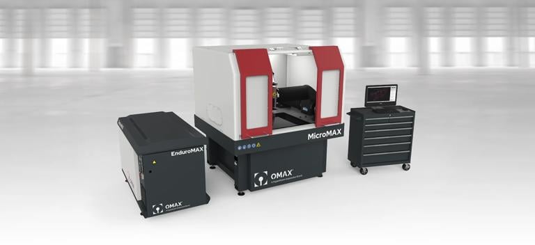

OMAX Introduces Taper-Free Cutting in Waterjet Micromachining
With its MicroMAX JetMachining Center, OMAX proves the speed, versatility and accuracy of abrasive waterjet technology now applies to the cutting of micron-level parts or part features from a wide range of materials, including exotic metals, advanced composites, polymer thermoplastics and glass.
Ideal for prototype development and production runs, the MicroMAX is a highly rigid machine...Read More »
