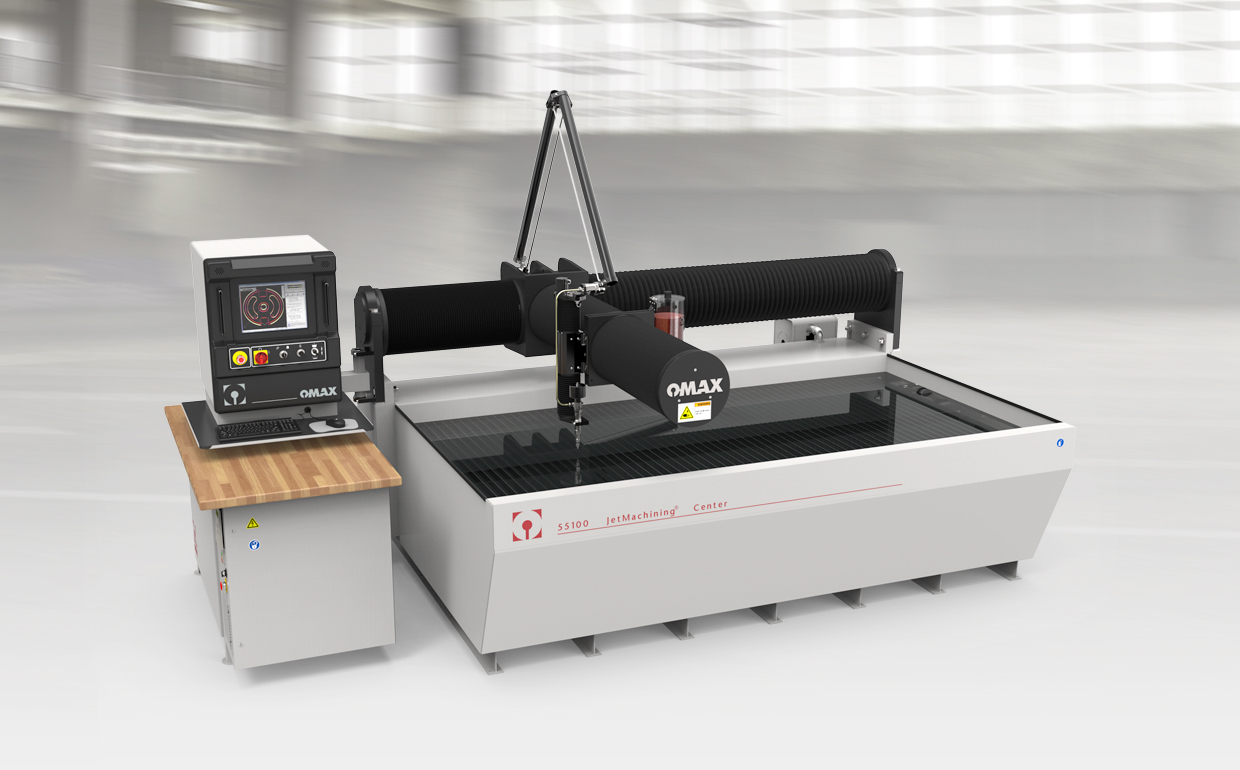

The OMAX 55100 is an excellent fit for shops needing a machine with a smaller footprint but capable of cutting medium-sized stock.
Cutting envelope of 8′ 4″ x 4′ 7″ (2.54 m x 1.39 m)
±0.001″ (±0.025 mm) linear position accuracy

Dimensions & specs
Machine Dimensions/Envelope
| Footprint (with pump & controller) | 15′ 1″ x 8′ 9″ (4.60 m x 2.44 m) |
| Height (with Scissor plumbing) | 10′ (3.05 m) |
| Operating Weight | 21,147 lb (9,592 kg) |
| Weight (tank empty) | 7,960 lb (3,611 kg) |
| X-Y Cutting Travel* | 8′ 4″ x 4' 7″ (2.54 m x 1.39 m) |
| Z-Axis Travel (with Motorized Z Axis)* | 8″ (203 mm) |
| Table Size | 10′ 6″ x 5' 5″ (3.20 m x 1.65 m) |
Model Specs
| Material Supports Slats | 4″ x 1/8″ Galvanized Steel |
| Maximum Supported Material Load | 400 lbs/sq ft (1,950 kg/sq meter) |
| Electrical Requirements | 3-Phase, 380-480 VAC ±10%, 50-60 Hz |
| NOISE LEVEL | Below 80 dBA at one meter for submerged cutting |
| Speed | 180 in/min (4,572 mm/min) |
| Linear Positional Accuracy* | ±0.001″ (±0.025 mm) |
| Repeatability* | ±0.001″ (±0.025 mm) |
| Ballbar Circularity* | ±0.0025″ (±0.064 microns) |
