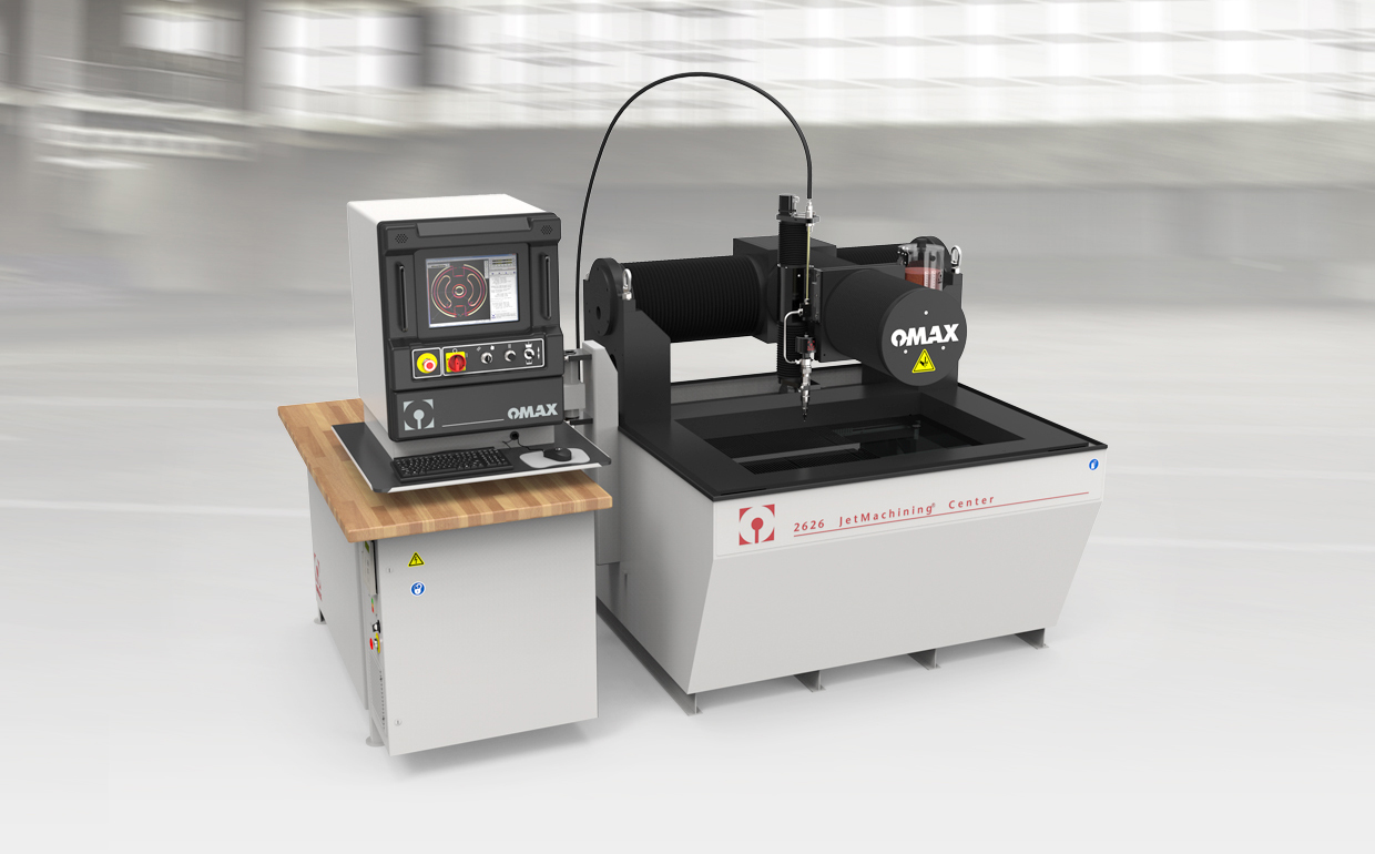

The small size and an efficient work envelope, the OMAX 2626 is a perfect fit for even the most space-challenged shops.
Cutting envelope of 2′ 2″ x 2′ 2″ (0.66 m x 0.66 m)
±0.001″ (±0.025 mm) linear position accuracy
