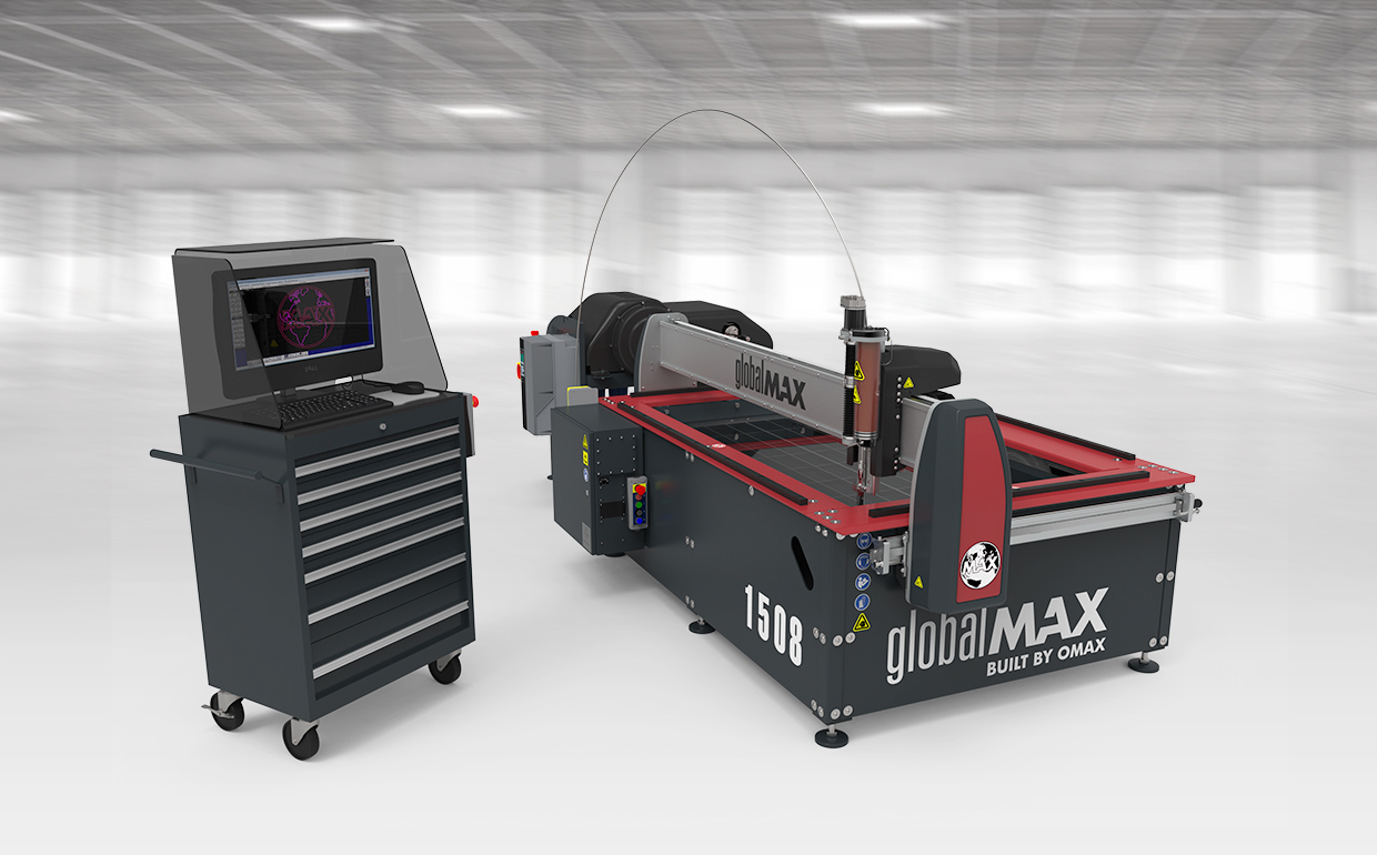

GlobalMAX 1508
Jetmachining Center
GlobalMAX 1508 Abrasive Waterjet
Features
  • IntelliMAX Global software uses our 4th generation cutting model to deliver the fast and efficient cutting
  • Innovative Omega Drive System provides smoother transition from rotary motion to linear motion compared to traditional rack and pinion drive systems
  • Omega Drive tooth engagement minimizes backlash and improves reliability
  • 1-year limited warranty
  • Fee-based training available
Dimensions & specs
Machine Dimensions/Envelope
Footprint (with pump) 5′ 3″ x 11′ 8″ (1.60 m x 3.54 m)
Height (with WHIP plumbing) 7′ 2″ (2.18 m)
Operating Weight (WITH WATER IN TANK) 5,400 lb (2,449 kg)
Weight (tank empty) 3,280 lb (1,488 kg)
X-Y Cutting Travel* 2′ 7″ x 5' (0.78 m x 1.52 m)
Z-Axis Travel 5″ (127 mm)
Table Size 2′ 10″ x 5' 5″ (0.86 m x 1.64 m)
Model Specs
Maximum Supported Material Load 100 lbs/sq ft (488 kg/sq meter)
Electrical Requirements Varies depending on configuration (See pump specs)
Speed 500 in/min (12.7 m/min)
Linear Positional Accuracy* ±0.003″ (±0.076 mm)
Repeatability* ±0.001″ (±0.025 mm)
Ballbar Circularity* ±0.007″ (±0.0178 mm)
Pump info
Direct Drive technology proven in thousands of installations worldwide
Efficient GlobalMAX pumps convert over 85% electrical power to pure cutting power
Learn more about OMAX pumps
  GLOBALMAX 30 HP GLOBALMAX 20 HP GLOBALMAX 10 HP
Motor Power 30 HP (22 kW) 20 HP (15 kW) 10 HP (7.5 kW)
MAX Jet Power 25.5 HP (19 kW) 17 HP (12.5 kW) 7 HP (5.2 kW)
Output Pressure 45,000 psi 45,000 psi 30,000 psi
Orifice & Flow Rate ** 0.015″ / 0.96 gpm
(0.33 mm / 3.63lpm)
0.012″ / 0.62 gpm
(0.30 mm / 2.35 lpm)
0.011″ / 0.40 gpm
(0.28 mm / 1.51 lpm)
Footprint LxWxH 52.5″ x 31″ x 42″
52.5″ x 31″ x 42″
