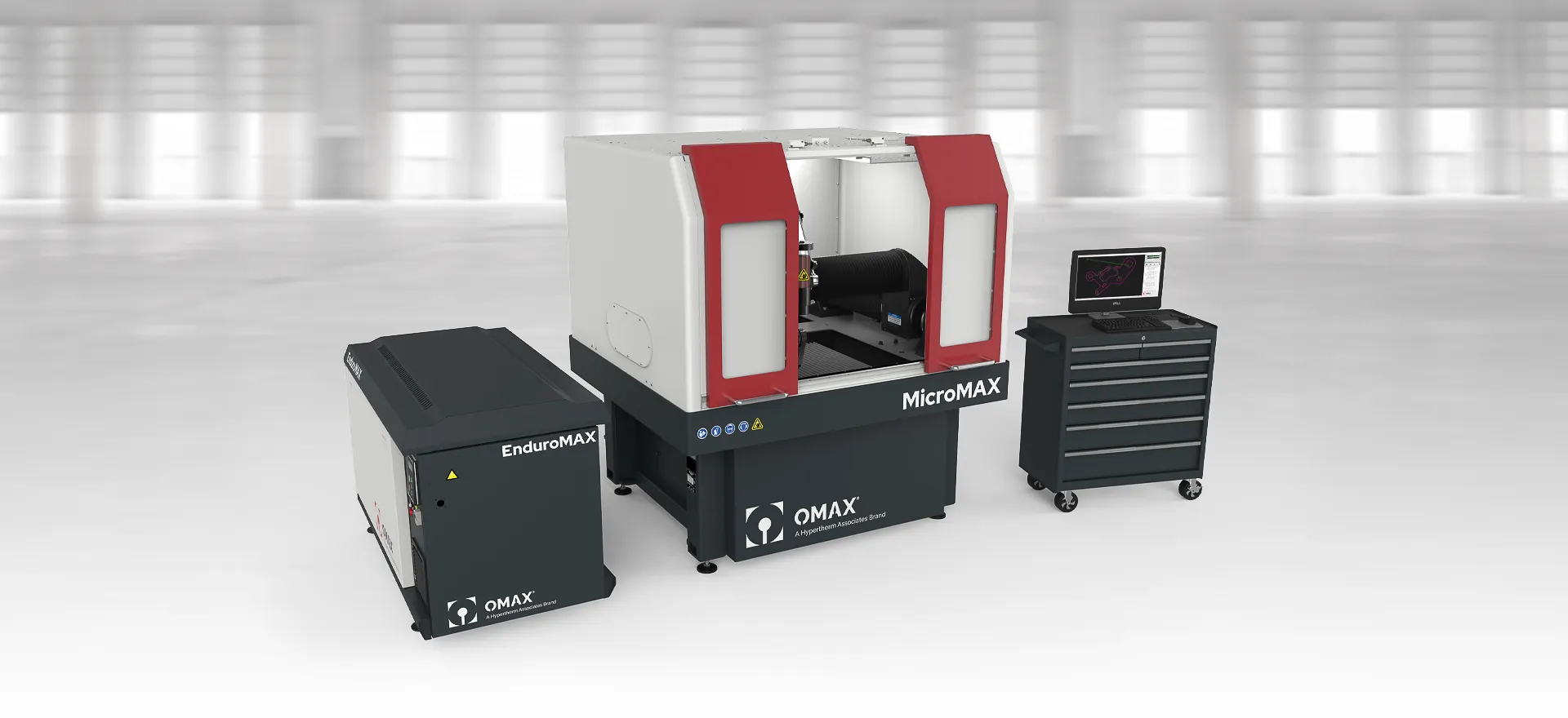

The MicroMAX has a small footprint and will fit well on any manufacturing floor or prototyping lab. The latest generation machine has been engineered for improved ergonomics and minimal environmental.
Contributing to the ultra-high accuracy of the MicroMAX is OMAX's proprietary linear traction drive system that uses optical encoders to provide 0.1 micron positioning accuracy. Protective bellows seal off all precision components inside the MicroMAX. The cutting table is mounted on a set of vibration isolators to minimize transmission of external vibration from the floor. A tank cooling package allows the control of the water temperature to within a couple degrees, helping to avoid any dimentional changes in the material as it's being machined.
A mobile work station with easy-to-use controller software provides the machine operator with convenient set-up and monitoring capability. The latest generation MicroMAX is compatible with the OMAX Solids Removal System so garnet can be removed without taking off the enclosure and draining the tank.
